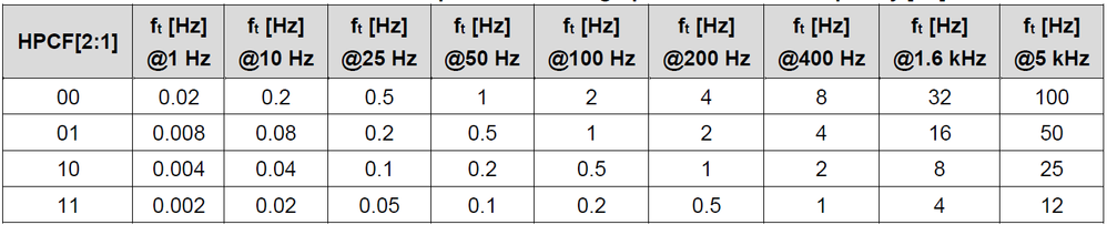

I would specifically like to add support for high pass filtering but I have no idea what HPCF[2:1] does - there was mention by someone at Pololu that the LSM303DLM datasheet has this information but can I fully trust that these filter coefficients are the same?

Concerning the high pass filter cut-off frequencies (HPCF[2:1] bits) I can try to get the values.

2018-02-23 5:02 AM
Here are the cut-off frequencies for high pass filter:
2018-02-24 2:11 PM
Thanks for taking the time for finding this information Miroslav
Much appreciated
