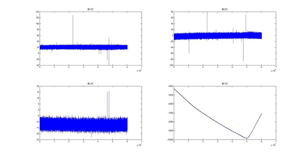

They are shaped like this. The figure contains triaxial gyro outputs and temperature output.

Hi @BLee.3 ,
the internal structure of the gyroscope is more susceptible to temperature changes than the one of the accelerometer.
so it is normal that disturbs presents first on the gyro.
These type of spikes can be filtered out at firmware level by analyzing the signal.
I would check if the last 3 or 4 samples have a spike and discard that sample.
hope this helps
Niccolò
p.s. if you found a solution to your problem, please, select a best answer to help other users with similar issues

Hi @niccolo.ruffini (ST Employee),
I have tried to utilize the latest 5 or 6 samples to get the median value.
This method works even though cannot elinimate.
