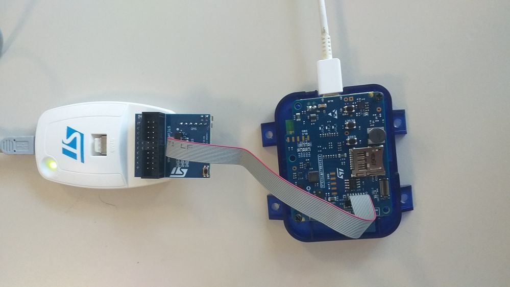

1-Connect the STEVAL-STWINBX1 to my PC with an STLink/v2 and a USB Type-C (picture)

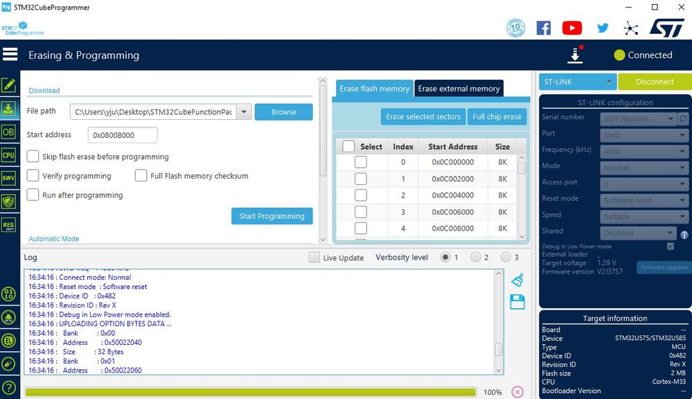

2-Open "STM32CubeProgrammer" and connect
3-Dowload the "DATALOG2_Release.bin" on the evaluation board

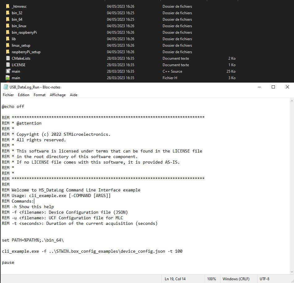

4-Try the example "USB_Datalog_Run.bat"

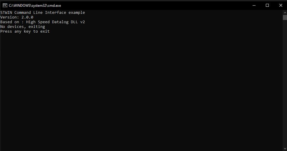

5-And I get the error message:
"STWIN Command Line Interface example
Version: 2.0.0
Based on : High Speed Datalog DLL v2
No devices, exiting
Press any key to exit"
I don't no why the example didn't work?

Hello @YANISJ ,
Can you repeat the procedure using 0x08000000 as Start address and enabling Verify programming and Run after programming?
Is the issue persisting also if you reset the board by pushing the RESET button after programming?
