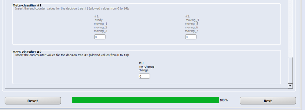

Now the problem is that I don't understand how to do it with Unico. At some point of the MLC configuration in Unico, it ask for the end counter for the meta classifier (see attached image), however there is no way of configuring the sub-group of the meta classifier (I would like the counter to be 1 for the no_change result and 10 for the change result). It looks like Unico groups the DT result base on some internal rule that I cannot control.
This is the meta classifier configuration in unico, I can only set the counter but I cannot configure the sub-groups.

Hi @Davide G_Oiovanelli ,
please consider this part below that we added to the Github example for multiple decision trees for your and similar purposes:
When two or more decision trees are configured, Unico asks to specify the list of labels for each tree, separated by semi-column. The corresponding numeric output is the position index (starting from 0). Dummy labels can be introduced in order to assign a different numeric output to a given label, as described in the following example:
