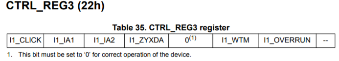

Hi @PDavi.5​ ,
I see you are writing 22h in CTRL_REG3 (22h) register. But if you want the DRDY on INT1, you should write 10h in the register (i.e. enable the I1_ZYXDA bit, datasheet p.34). On Github you only have the example for polling mode reading, not interrupt driven (except in the FIFO case).
0693W00000Bc9JHQAZ.pngI also suggest you to set the BDU bit in CTRL_REG4 (23h) register.
Let me please know if this can solve your issue.
