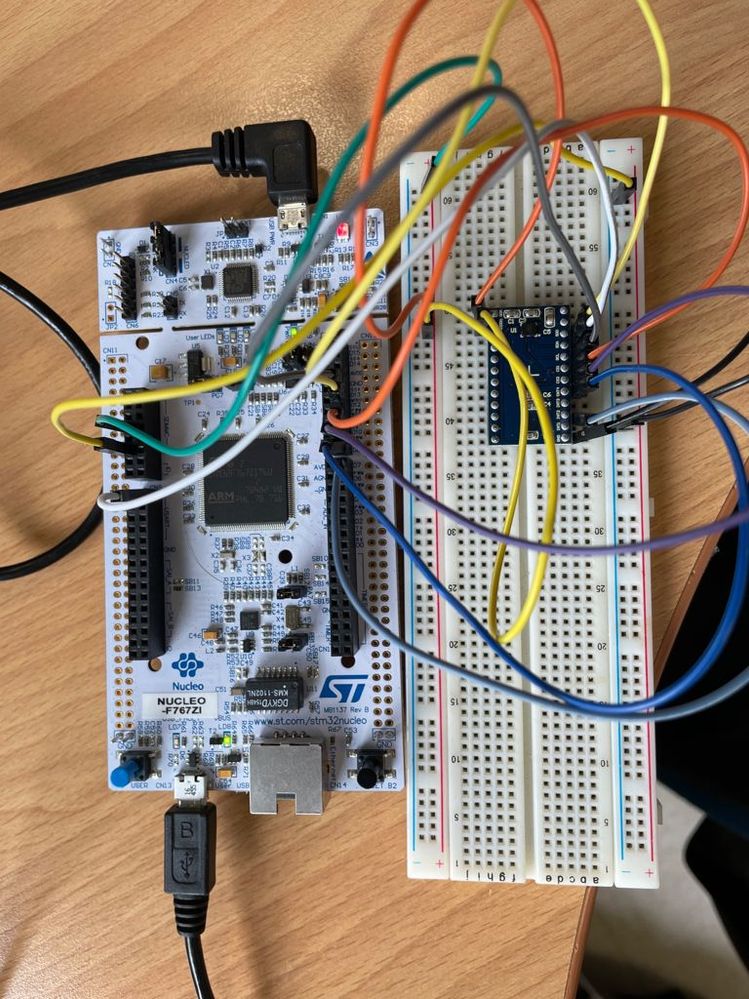

Hi Eleon,
I basically use VSCode for debugging as well as developing. But I've also checked with the STM32CubeIDE and I get the same result.
The code gets stuck in the while loop, which apparently never ends. It is not easy to understand what is actually happening. Furthermore, the sensors are embedded in the microcontroller and it is rather difficult to access the pins with the scope to check what's going on.
Another observation is that I tried the SPI communication without the DMA and the result is the same.
