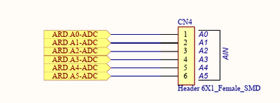

Ok, no audio-dac , but you have also the on chip dac , 2 x 12 bit.
I would try this to test the audio signal.
here:
on "Arduino connector" :
To use it, you have to modify the xx.ioc file, set PA4 + 5 : unused, then activate dac.
Then can see on a scope, what signal you producing or connect an amp, to listen...

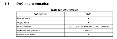

here:
Yes, I checked the documentation and there is a DAC on pins PA4 and PA5. I will try to use an amp. Thanks for the advice!
