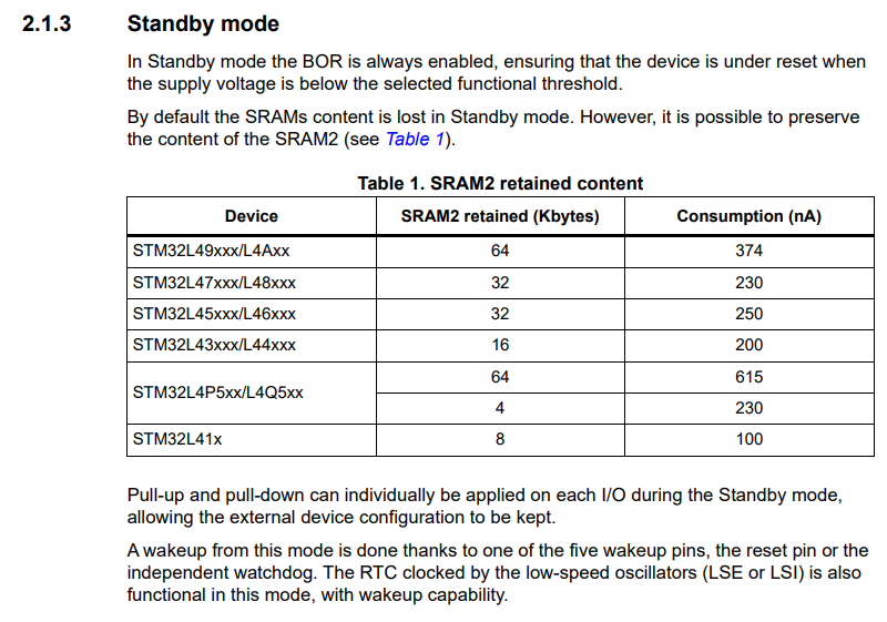

from this video in another product, i did understand how to make the stm32 product go to standy. But how do i do the auto wakeup from low power mode. I saw from the reference Manual for stm32l4
To wakeup from Standby mode, there is no need to configure the EXTI Line 18.
But how do i exactly make it wake up from standby mode?
2020-03-06 4:46 AM
Hi @reokyouma , I suggest you to check the AN4746, where you can find all the details to wake up an STM32L4xx MCU from stand-by mode. In particular, you have to use one of the WKUP pins. In 5.3.3 chapter of the Ref manual RM0432 you can understand how to do it: in the HAL libraries the function to be used is HAL_PWR_EnableWakeUpPin( … )
