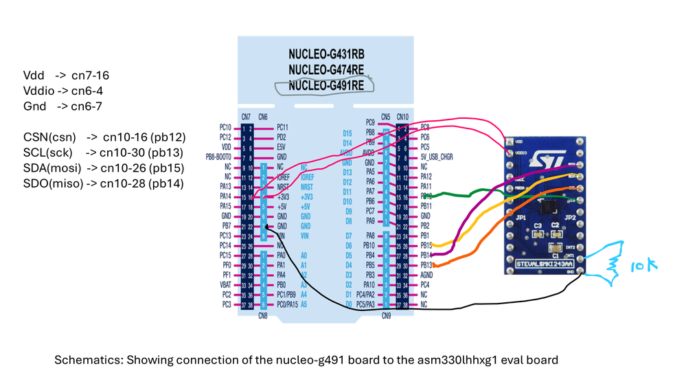

Connected STEVAL_$MKI243AA board to a nucleo-g491re board using 4 wire spi interface. The spi bus is setup to run @ 146 Kbits/sec. Reading back bad data.
WHO_AM_I is 0x48
PIN_CTRL is 0x3E
Not sure but seem like the device is power

A good, clear photo of your actual setup would help.
Check connections very carefully - particularly Vdd & GND.
@arifkhan wrote:The two evals boards are jumpered as shown with 8" jumper wires.
These are quite prone to poor connections.
As noted above, your MISO behaviour very much suggests poor connections.

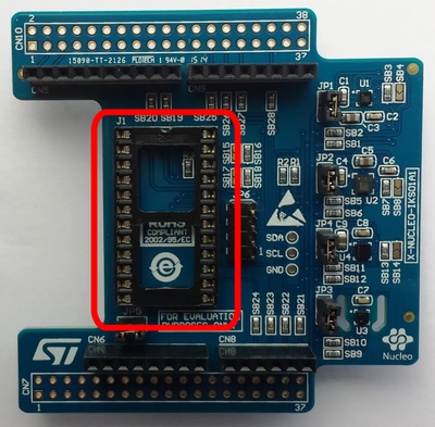

I would strongly recommend one of the X-Nucleo-IKS adaptor boards ("shields") - which accommodate the 24-pin DIL pinout; eg,
X-NUCLEO-IKS5A1 - X-NUCLEO-IKS02A1 - X-NUCLEO-IKS4A1
These models are Obsolete, but still usable if you happen to have one:
X-NUCLEO-IKS01A3 - X-NUCLEO-IKS01A1

@arifkhan wrote:Do you see anything in the code?
Looks more like a hardware problem to me.
