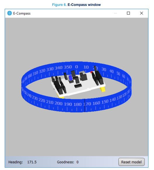

See below an example of the output of MotionEC library in Unicleo-GUI framework �?�
