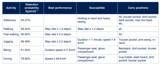

See below the detailed output of the activity recognition of MotionAR algorithm! �?�

Here below a table describing the algorithm performances:
