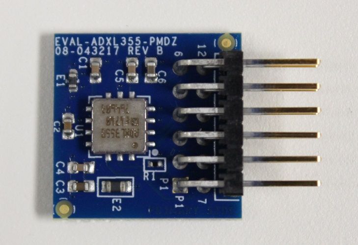

Hi everyone,
I am trying to bring in sensor synchronization for accurate data acquisition in a wireless sensor network built using STM32F407 Discovery.
ADXL355 Digital accelerometer (shown below ) provides full external sync by applying an external clock (enabled via the EXT_CLK bit) at 1.024 MHz on the INT2 pin (Pin 13) and an external synchronization signal, SYNC, on the DRDY pin (Pin 14). The pulse width of the SYNC signal must be at least 3.91 μs, which represents four cycles of the external clock
(4 ÷ 1.024 MHz = ~3.91 μs).
I used (Digilent) Analog Discovery 2 to provide an external clock 1.024 MHz and a SYNC signal 256 KHz ( 1.024 MHz / 4 ).
When I tried this I can not get any response from the sensor but it worked good with internal clock.
Can anyone help me to fix this problem?
