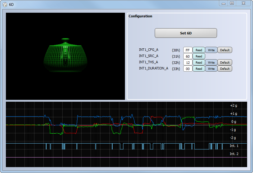

Please read Chapter 6 - 6D/4D orientation detection in application note
https://my.st.com/resource/en/application_note/cd00290365.pdf
.You can see example of 6D orientation settings in following picture:

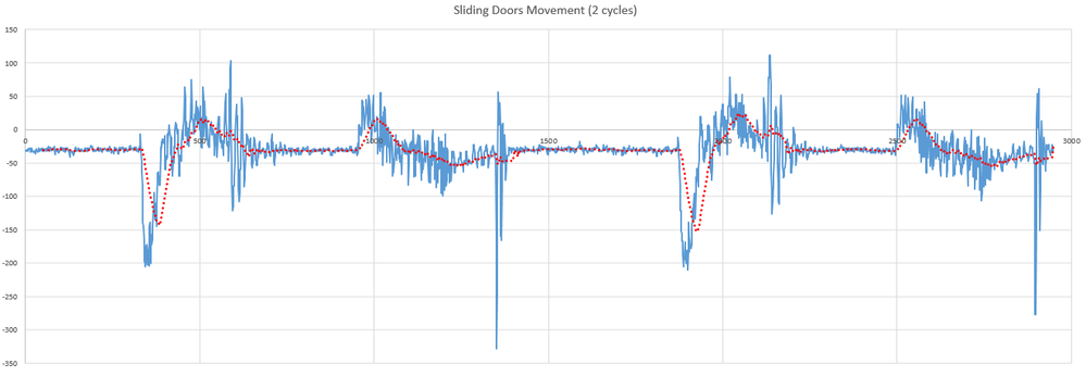

in principle it is possible to detect movement of sliding doors. The gravitation acceleration will be in perpendicular axis to the door movement, so it is not a problem.
I did quick test with automatic doors in our office (stick accelerometer on sliding door record the acceleration), here you can see the results:
I also did an analysis in excel and added moving average:
I can imagine that this could be used for example to make counter of door opening.
I don't know what exactly is your target, in any case you will have measure acceleration of your doors, because each door can generate different pattern.2017-02-07 3:37 AM

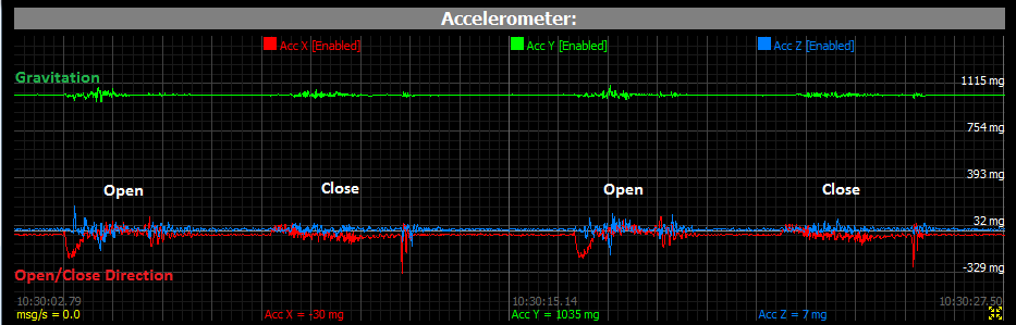

2017-08-14 4:11 AM
The decision if the sliding doors are opening or closing was made by the sign of the acceleration at the beginning of the movement.
According to sensor orientation the sign will be positive when opening and negative when closing or vice versa.
I recommend you to make a trial, record the acceleration data and make the analysis offline.
2017-08-15 11:50 PM
Thank you for your reply Miroslav!
Observed the scenario with LIS2DE12 accelerometer that the sign is negative when the door is closed, & it tends to be positive when the door is opened.
Please find the accelerometer readings observed with the different position of the device with 6D enabled.
