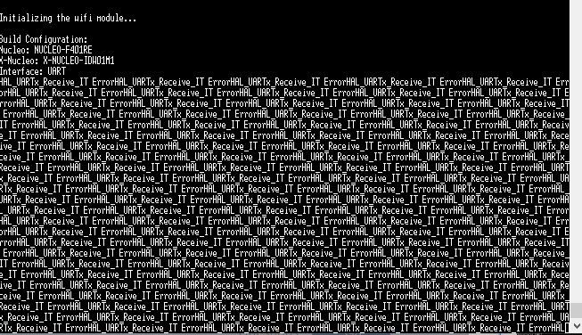

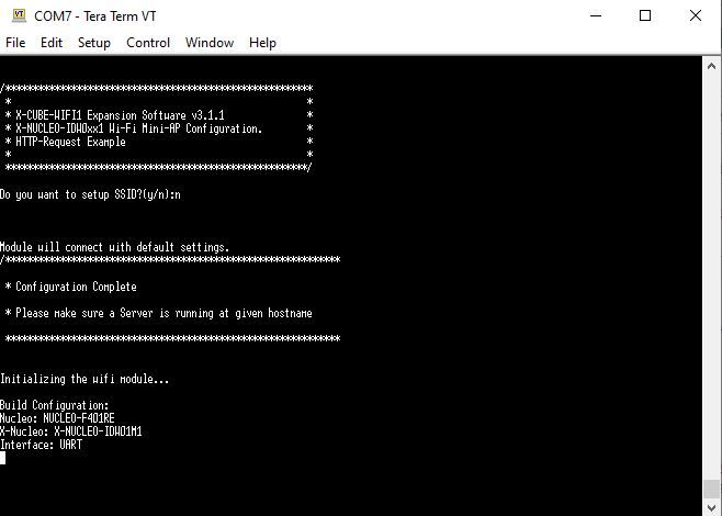

I'm using a nucleo F401RE which is supposed to be compatible with this expansion board. I just plug both boards and run the examples. Once the program is running I used the default SSID configuration (which I modified to be my own router configuration) and then the program gets stuck initializing the wifi module. Like the following picture:
After waiting for a while it prints HAL_UARTx_Receive_IT Error a lots of times.
