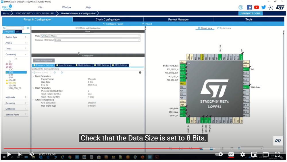

I found it: in cubemx the default spi data size was set to 4 bits instead of 8 bits
2022-07-22 9:08 AM
Good!
This information is indeed reported in the Getting Started Guide
and in the webinar as well
Enjoy your STM32 application!
