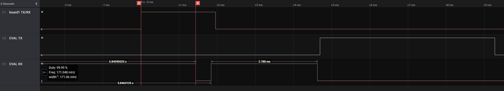

2022-02-14 5:37 AM
I noticed S2LP continues to listen for 1.5ms approx after it detects something, then listen again but don't stop when board1 is sending, listen for 2.7ms and send its packet.
Indeed, in the first image, the change RSSI occurs 1.5ms before it stops listening.
