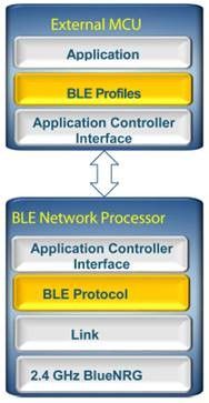

2020-02-19 8:35 PM
NXP MCU will need to control the BLE chip thru the standard HCI/UART interface.
MCU is a application processor and SPBTLE-1S is the network processor, like:
In the picture, ACI is the HCI interface extended with ST vendor specific commands.
Please refer to ACI documents under BlueNRG GUI package: C:\Program Files (x86)\STMicroelectronics\BlueNRG GUI 3.1.0\Docs\gui_aci_html\
BlueNRG GUI software package:
