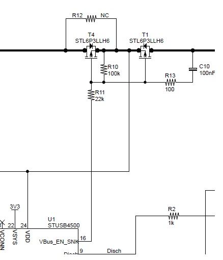

Sorry I forgot to mention we wish to use the STUSB4500

Please refer to STEVAL-ISC005V1
STUSB4500 is a standalone USB PD controller. When connecting to a Type-C supply, it recognizes that the supply does not have PD capability, then automatically consume the power with Type-C only (5V 3A ex).

Two related questions for you, referring to the below paste from the STUSB4500 eval board schematics:

If removing T1, it will not compliant with the standard. Therefore, it is not recommended to remove T1.
If removing T4, there will be no negative voltage protection and no reverse battery protection. Thus, you may trade off keeping it against removing it based on your application needs.
