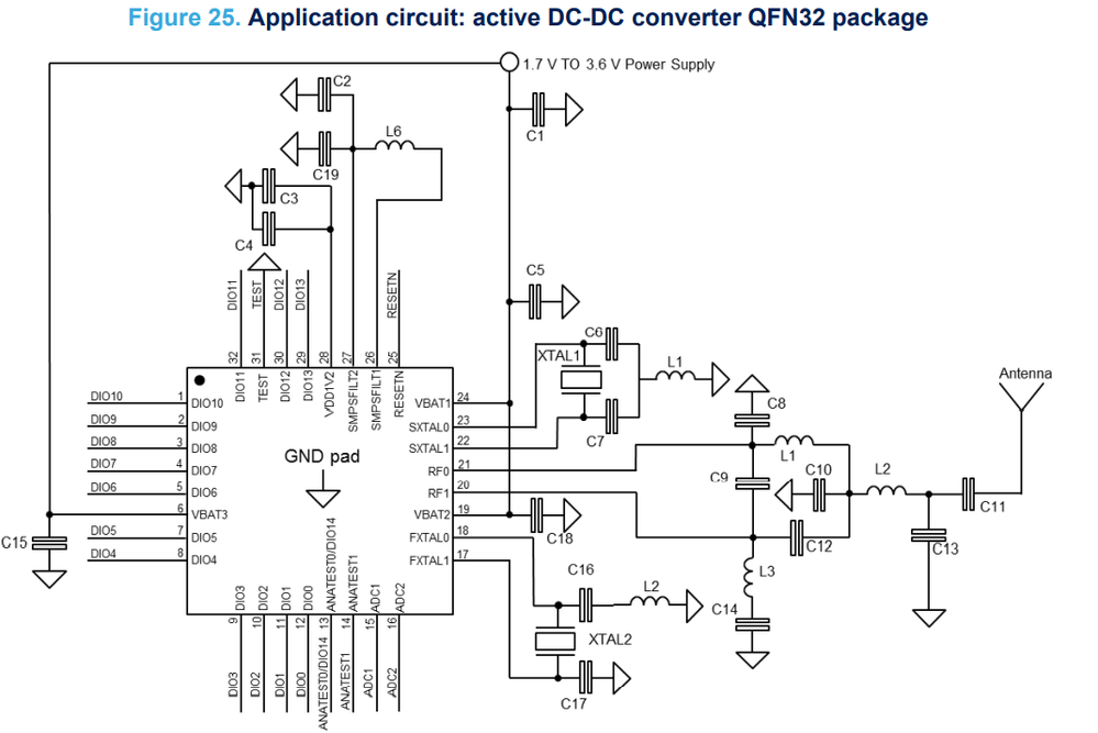

Hello, wanting to use the Bluenrg-232 in a design using the typical application. Where would I find the values for the components?
Thanks

Please refer to STEVAL-IDB008V2 evaluation board.
https://www.st.com/en/evaluation-tools/steval-idb008v2.html
BOM is available online.
https://www.st.com/resource/en/schematic_pack/steval-idb008v2_schematic.pdf
