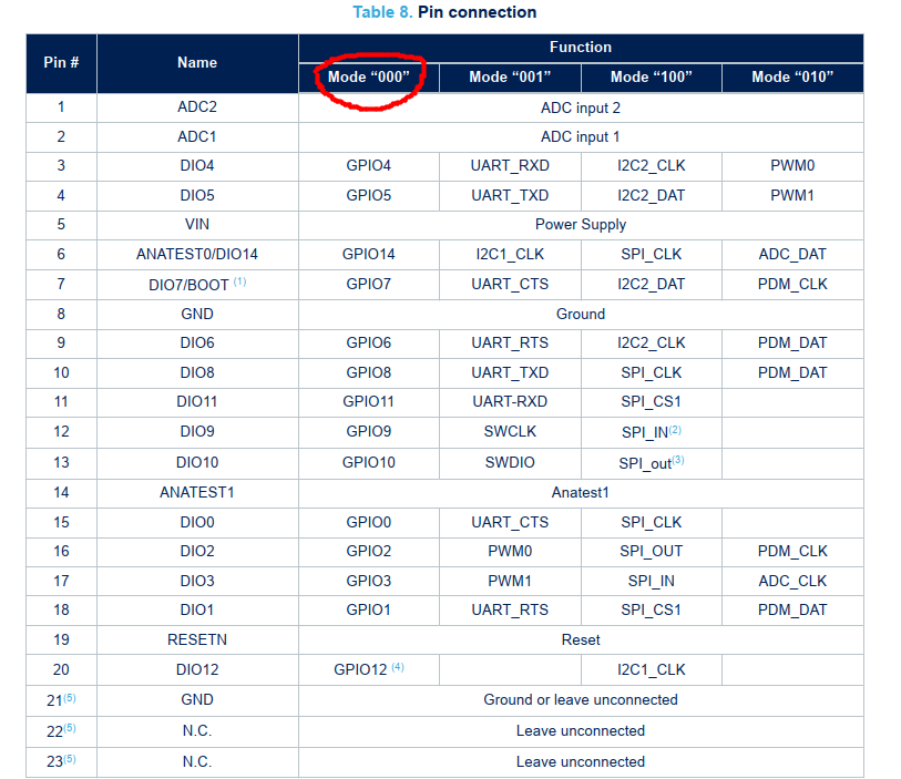

BlueNRG-M2 Pin assignment has 4 mode options. Can I set them? Can they be combined? Are there only analog inputs?
PR.10
Senior
described in table 8 of BlueNRG-M2 datasheet. But there is no description of what the Mode is.
Is it a pin or SW configuration or model type?

mode 000 = GPIO mode
mode 001 = Serial0 mode
mode 010 = Serial1 mode
mode 101 = Serial2 mode
Those are the operating modes that I/O pins can be configured.
The modes are set in registers GPIO-MODE0 ~ GPIO-MODE3,
at offsets GPIO_BASE_ADDR+0x2C ~ GPIO_BASE_ADDR+0x38
See also BlueNRG-2 datasheet, chapter 3.12 GPIO
https://www.st.com/resource/en/datasheet/bluenrg-2.pdf

I read there is a pin, but could not find it. This explains it. If I set sections differently it is at least palatially configurable then.Thanks for fast replay.
