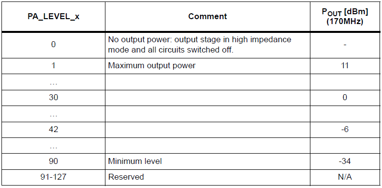

Incrementing by 1 the PA register value will correspond about to half dB decrement of output power.
The following table would be the values to output power levels.
