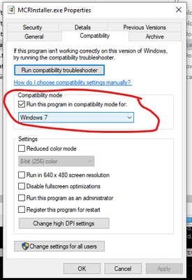

Just ran into this problem myself. The fix appears to run the Matlab Compiler Runtime installer "MCRInstaller.exe" from the zip in Windows 7 compatibility mode.
