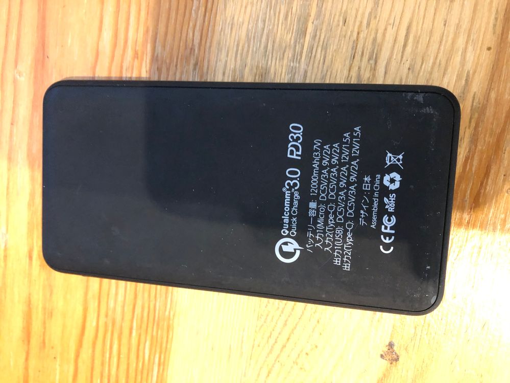

2020-01-16 7:30 PM
The above photo is the PD power bank I am using for testing. It support 9V/2A, 12V/1.5A. I tried to configure it to have 20V/1.5A, 12V/1.5A. The 12V/1.5A should be a valid PDO.

2020-01-17 3:00 PM
Indeed the 12V profile should work with this power source.
But this power source cannot provide the 20V profile.

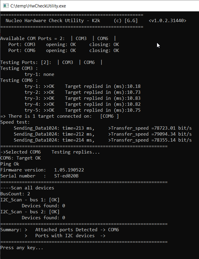

2020-01-18 12:12 AM
Hi, I used the new version of the GUI. It still cannot find the board. I used the HwCheckUtility.exe. The output log is capture in the above picture. Does it mean that there is a problem?

2020-01-20 11:57 AM
The output of HwCheckUtility.exe shows that it cannot detect the Nucleo-Board. So there is indeed an issue.
Even if the I2C chip is not connected, the utility should at least detect the Nucleo-Board.
So it means the firmware is not flashed properly into the STM32 Nucleo-Board.
When the firmware is running properly, the green LED (LD2) must be blinking.
Here is an example of what you should get when the Nucleo board is detected:
