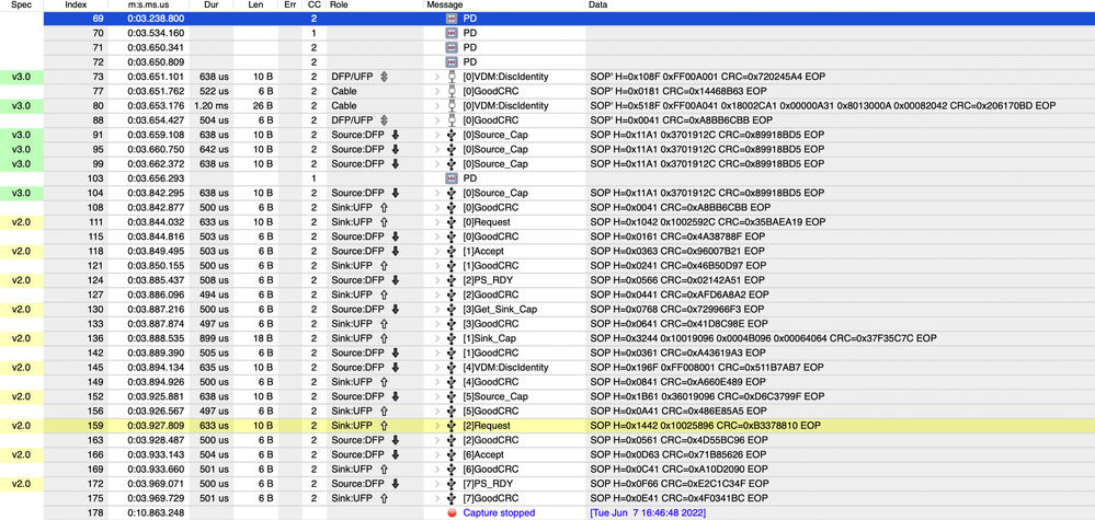

Could you please ensure that you have set, stusb4500, bit USB_COMM_CAPABLE in NVM ?
I suspect that the macOS is checking all bits in Request message and enables its DFP only if Sink is UFP capable.
While using A-to-C cable, legacy host port always enables DFP terminations.
If you have possibility to share USBPD trace, it would be nice.

Thanks for your reply. I will check the USB_COMM_CAPABLE bit, in the meantime please see attached screenshot and csv export of pd trace.0693W00000NrWhAQAV.png

The USB_COMM_CAPABLE bit was not set, changing it in NVM solve the issue.
