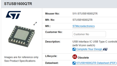

1. Mouser marks the device as "obsolete". What is the EOL of the STUSB1600 and what alternative is recommended (STUSB1700?)?

Re. 1: You mean this one? STUSB1600AQTR STMicroelectronics, the same one that ST marks as "active"? STUSB1600 - USB Type-C controller (with short-to-VBUS protection) - STMicroelectronics
2025-05-08 11:56 PM
Yes, exactly. I Wonder why Mouser sets it to obsolete....
2025-05-08 11:58 PM
Ah I see: The STUSB1600QTR is "obsolete" but the "STUSB1600AQTR" is not!
Thank you for the clarification!
2025-05-08 11:59 PM
But I linked to the AQTR version. There's the difference.

Hello
1- STUSB1600AQTR is the valid reference (stusb1600qtr has been replaced by this one since long time). This is the reference used on MP1 board.
