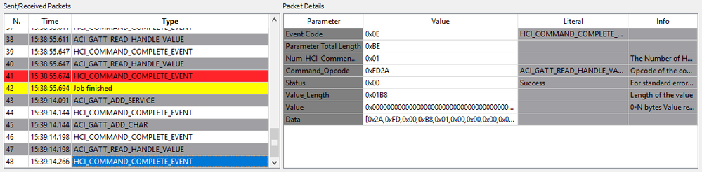

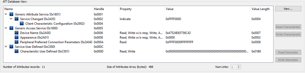

For MODE2,
The following would be my quick test adding a service and a 440-byte characteristic in addition to default attributes. (which can also be a reference about the memory array used by default attributes). There is no special meaning for the length 440 byte, i just picked up some value larger than 410 randomly.
The followed is calling ACI_GATT_ADD_CHAR with 2-byte value (0x01B8) for charValueLen.

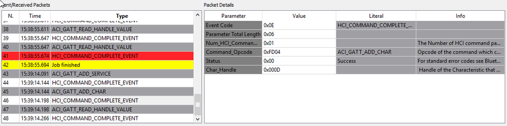

The followed is the event showing ACI_GATT_ADD_CHAR was completed successfully.
