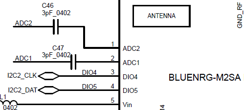

Hello, I've been using the STEVAL-IDB008V1M to help develop an BLUENRG-M2 product for an company. I've noticed in the schematic there are 3pF capacitors connected to the ADC Input 1 and Input 2
Does anyone know why this is done?
For the time being I have linked across this. I'm using the ADC polling example code and for some reason I always read 1239mV even with no power source connected.

2023-07-09 1:14 AM
Old topic, but I've got the same issue. I was wondering why DC measurements don't work. Finally I found C46 and C47, bridged them and since then it's working fine. I'm really wondering what their purpose is. I find it really counterintuitive not to be able to measure DC.
