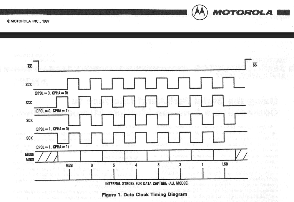

An active-high SPI chip select??!
Surely, CS is active-low by definition* in SPI ?
via: https://en.wikipedia.org/wiki/Serial_Peripheral_Interface#Operation
That must be incompatible with just about every other SPI definition in the world ?!
* Insofar as "SPI" has any formal definition.
