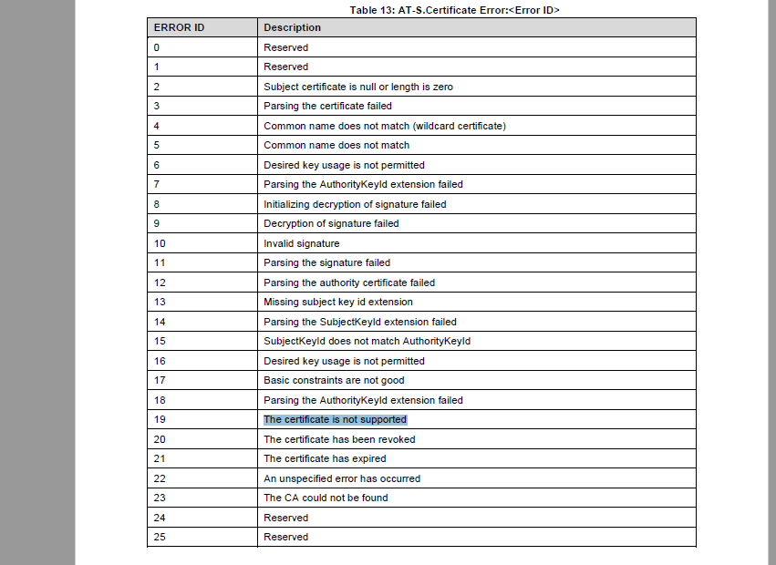

According to the Certificate Error : 19, returned by firmware socket, that message means that the certificate is not supported!
2017-10-30 6:23 PM
Yup, thanks for that suggestion I upgraded to the SPWF04...

FW1.0.0 only supports RSA-based certificates. No ECC-based certificates. What kind on certificates are you using? Please refer to AN4963
2017-11-07 8:41 PM
Yup I'm missing the server side certificates...Seems anonymous mode does not get supported in TLS2.0.
