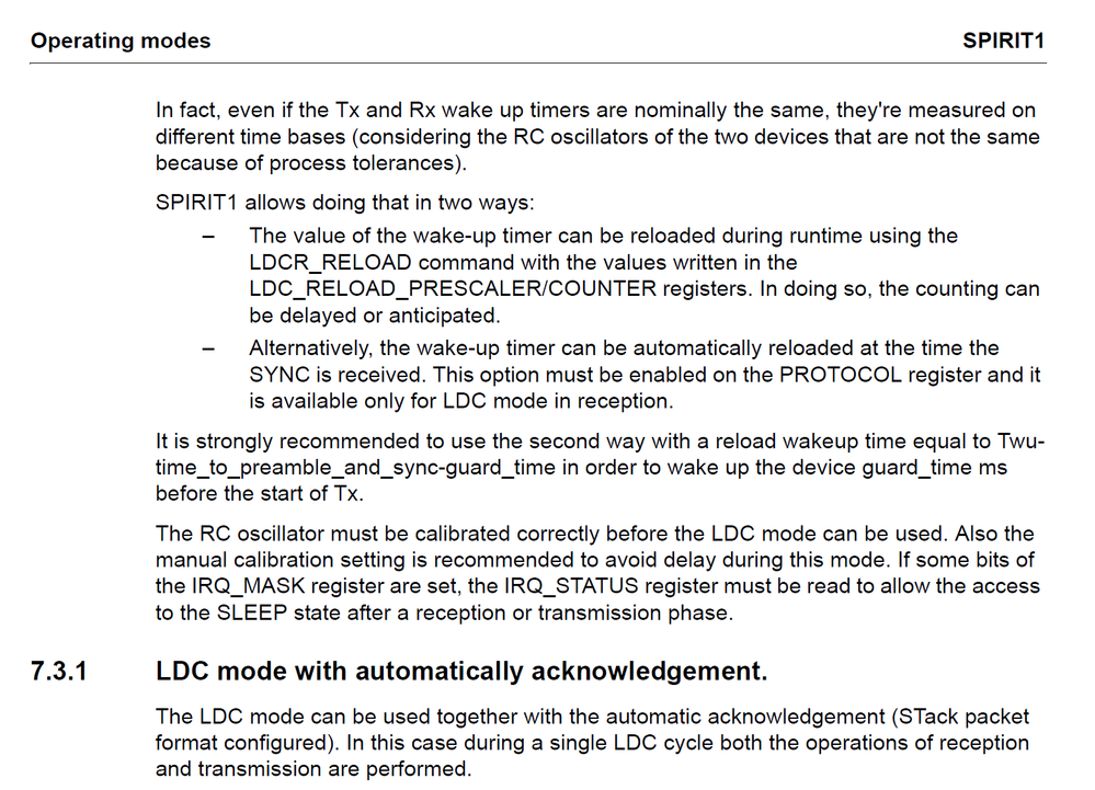

Update: I have successfully configured the receiver in LDCR mode and exiting the LDCR mode. I disabled LDC (sleep) mode by writing the bit 0 into the LDC_MODE field of the PROTOCOL[2] register and then transitioning the SPIRIT1 device into READY state upon each RX_DATA_READY interrupt. As for enabling the LDCR mode, I had to configure the Wakeup timer (registers 0x55, 0x56), the Rx timeout (registers 0x53, 0x54), and enabling the LDC mode every time the receiver receives data (configurations done prior to the state transition to the RX state).
This method has issues - the receiver could only receive data at certain timeframes. I set the RX timeout to 2 seconds and the wakeup timer to 1 second. I utilized a user LED to observe the state transitions (flashes when the SPIRIT1 is not in its SLEEP state, and disabled/off when SPIRIT1 is in its SLEEP state). The light blinks every 4 seconds (with the pattern: 1st second - on, 2nd second - off, 3rd second - off, 4th second - off). I noticed that the signal is received correctly from the transmitter when received on the 3rd, 4th, and 1st second (fails when data is transmitted exactly after the 1st second till the end of the 2nd second).
I have been reading on automatically reloading the wake-up timer at the time the SYNC is received, but I do not understand how to achieve this. I have tried configuring the LDC_RELOAD_PRESCALER and LDC_RELOAD_COUNTER values (registers 0x57, 0x58), and activating LDC_RELOAD_ON_SYNC in PROTOCOL[1] but it does not resolve the issue. Is there a method to wake up the device properly when the receiver is still in its SLEEP state? Any help would be greatly appreciated.
