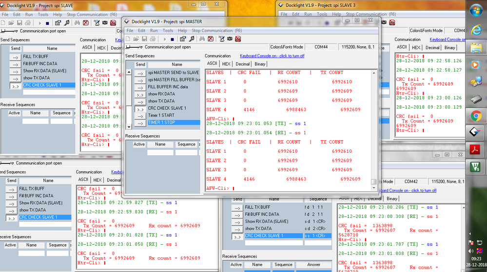

Initially all slaves work correctly bt after some lakhs of tx and rx it SLAVE 4th get errors

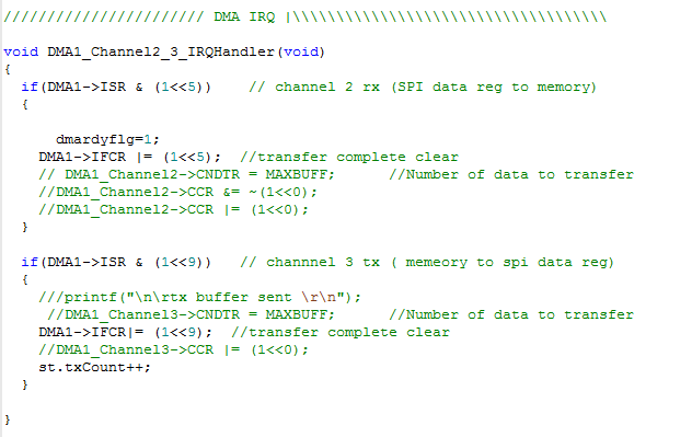

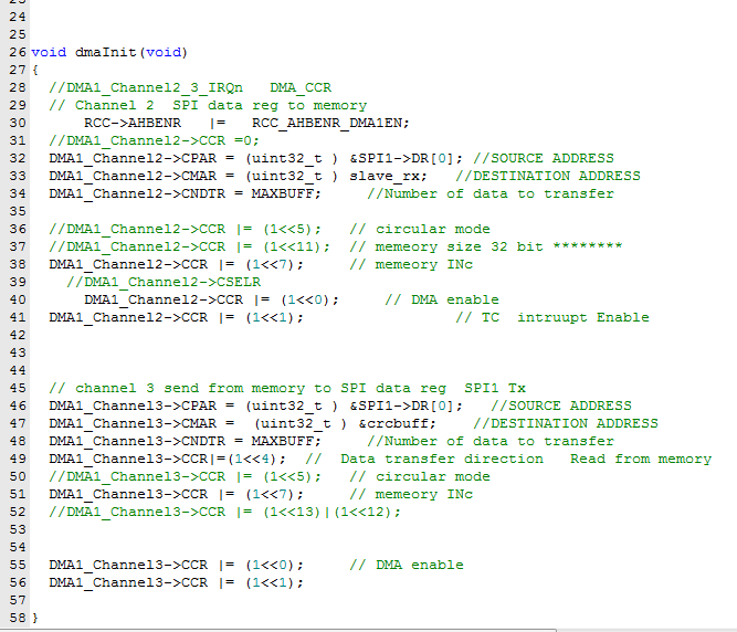

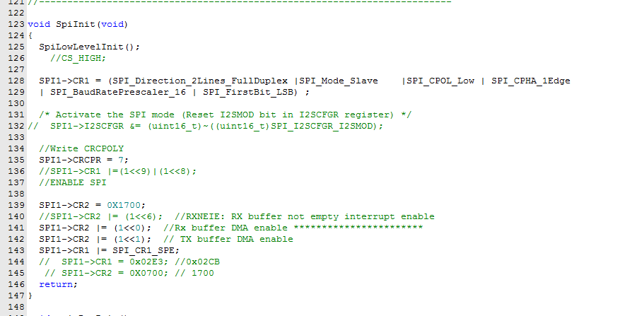

M0 SLAVE SPI AND DMA CONFIG

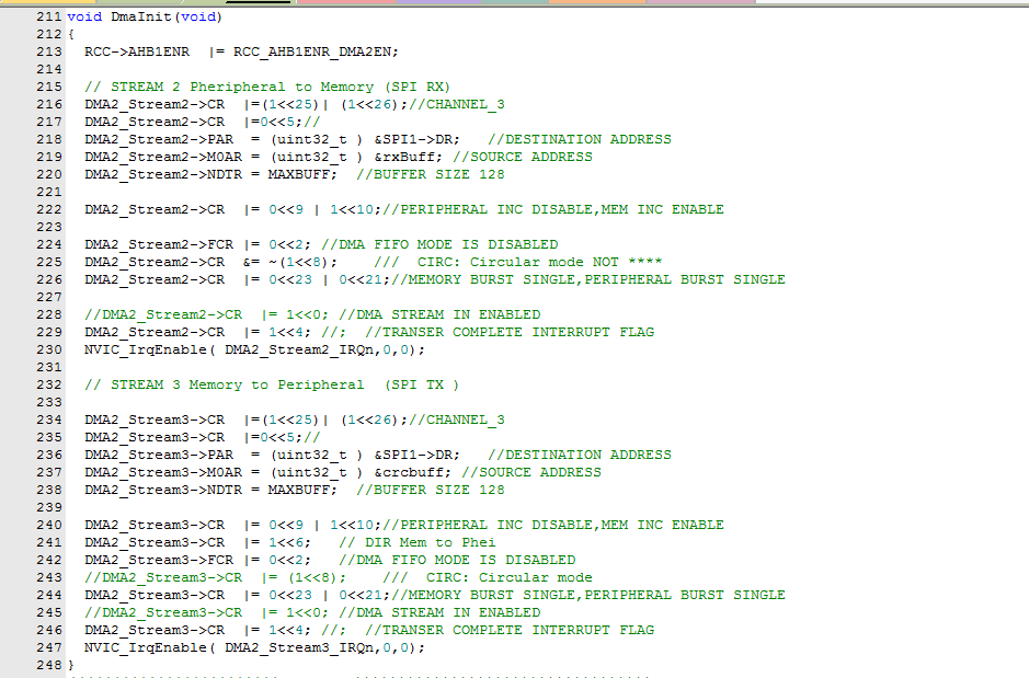

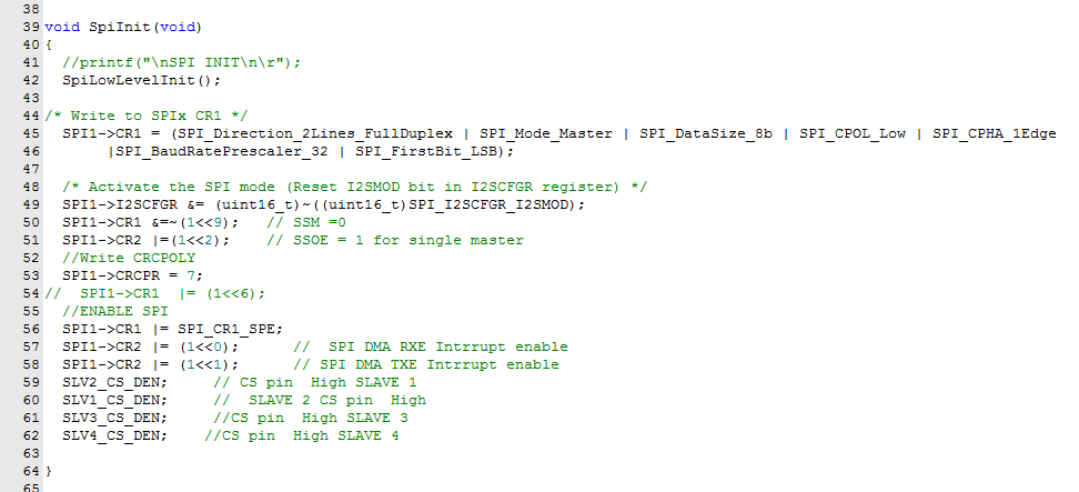

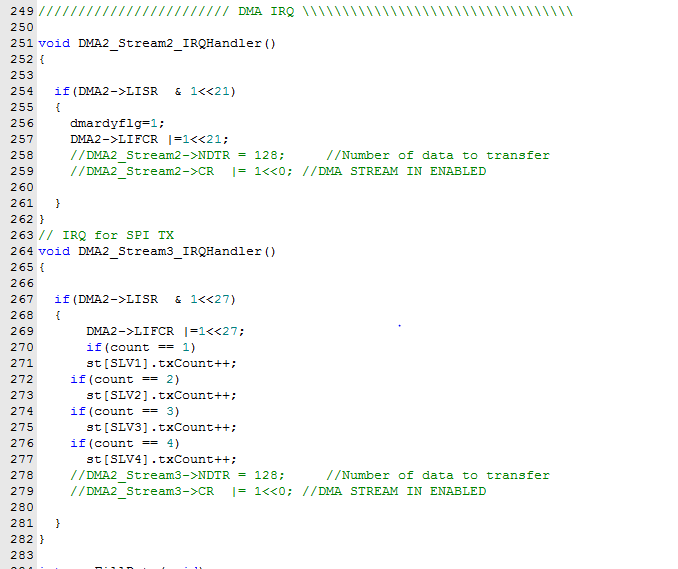

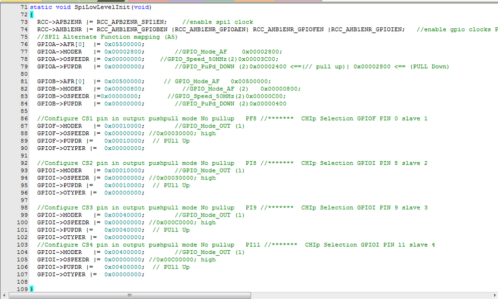

**** MASTER SIDE SPI AND DMA CONFIG ****
below:
(Cortex M3) MASTER stm32F20x
Thanks in advance.

An SPI transaction is complete once its RXNE flag is set. (not TXE).
Use NSS rise/fall edge to reset/reconfigure the SPI for the next transfer.
Add some slight delay on master side between NSS toggle and SCK data activitiy start.

Does this MCU SPI has FIFOs?
Hard to see the captures. Are the SPI Slave MCUs using DMA in CYCLIC mode?
Are you using EXTI on the NSS slave pin?
2019-01-04 3:05 AM
hello,
captures are clear when you click or zoom them
No CYCLIC mode am using

2019-01-04 11:20 AM
The most important to remember in SPI mode is that the TXE will occur just when you write the data register, while the RXNE will occur once all the clock bits have been actually been transiting on the SPI bus. Going higher level, the DMA RX usually is used as possible interrupt source, never the DMA TX which is only used in master mode to generate the required number of clock pulses. (in 4 wire mode which is the default reference for me).

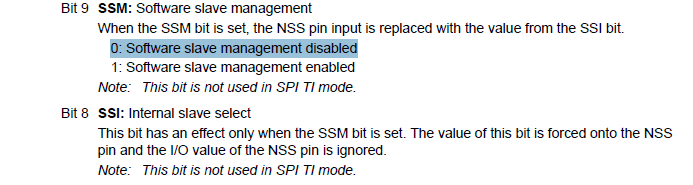

2019-01-07 3:03 AM
hello,
as you told to check Chip select Pin
when am using this config : SOFTWARE SLAVE MANAGEMENT DISABLED
so my Question is that how i can see/ Check my Chip Select pin is high or low ?
if you having some codes so, please share with me .
