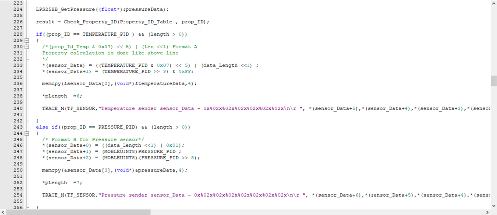

May I ask how the android app extracts the propertyID of the sensor? Looking through the firmware, I see this Appli_Sensor_Data_Status() function in appli_sensor.c, but the comments don't clearly explain what format A and format B actually mean other than use format A for temperature, and B for pressure. Are these formats described somewhere, and are there other formats besides these two?

These are the formats for Marshalled Sensor Data given in the Mesh Specification freely downloadable from :
https://www.bluetooth.com/specifications/mesh-specifications/ .  Mesh Model Specification 1.0.1 Section : 4.2.14 , Page 120.
Client(Smartphone in this case) sends the getSensor command with the null property Id or the Property Id of the Sensor and get the Data in the Sensor Status.
Android App knows the property id of the Sensors supported already .Otherwise it should invoke 4.2.1 Sensor Descriptor Get command to get the currently supported sensors(coming in future release).
