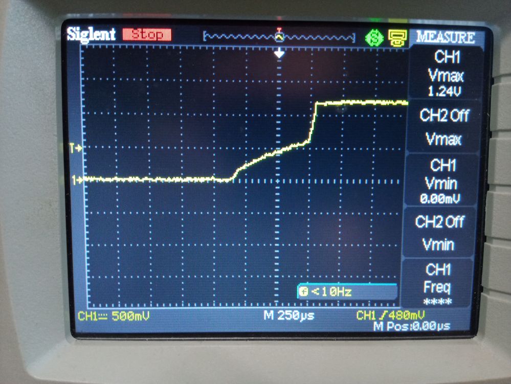

2019-10-10 3:34 AM
Hi Winfred,
I create switch based board to select commands on nucleo board. I'v got 5 switches:
1 - init S2LP registers,
2 - check MC_State's,
3 - send frame (send fifo bytes and tx strobe),
4 - set SDN pin,
5 - reset SDN pin.
Now the first sequence: 4,5,1,3,2 and the board stuck with MC_State0 = 0xE9 (atachment 1-BAD.jpg is the voltage on VrSynth). Then I do the same sequence (board have still a power supply) and then the board work good and the MC_State0 = 0x01 (in the TX_Sent isr arrived), the voltage in Vrsynth look's rising faster(2-good.jpg).

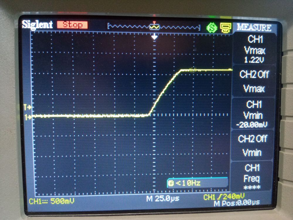

}As you see here is a difference with load cap time and the shape for a first run.
Here is a second start:
Thank for a replay.
