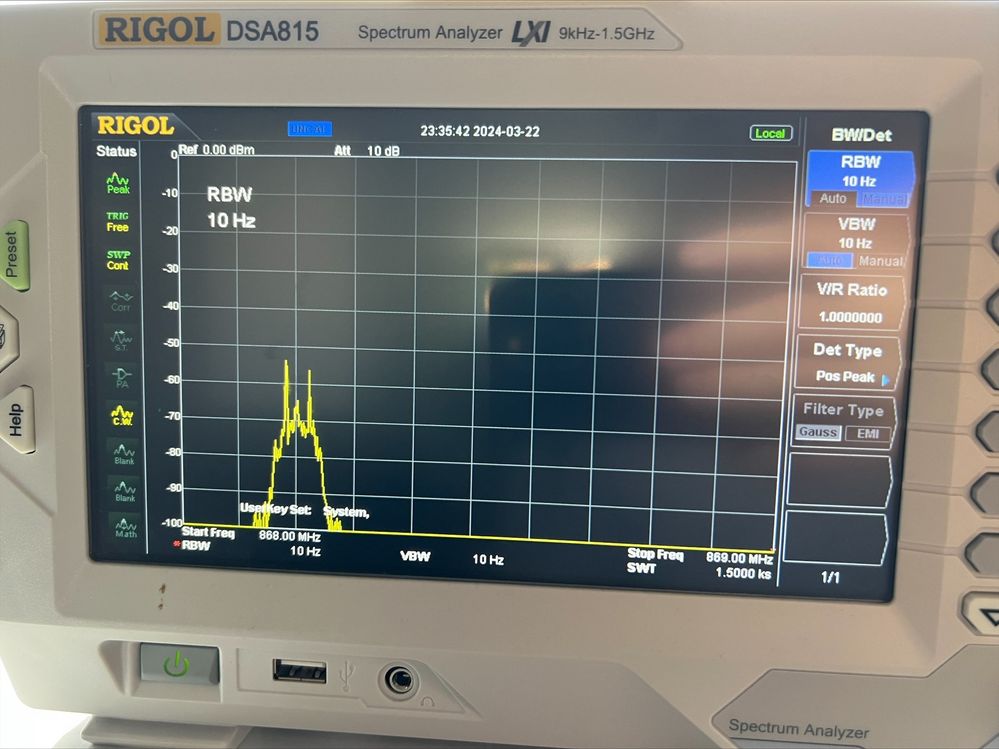

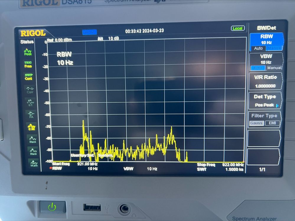

I have attached some pictures of some investigation I did with a spectrum analyser to see the difference between the two settings. It's clear that some drop in range is going to occur, but is it expected for it to be so drastic?

Could it be that, in addition to the 10dB drop, your antenna is also optimised for 868MHz and has even lower gain at 921MHz?

Thanks a lot for the response, this may be very helpful. The antenna we use on our receiver is the FLEXI-SMA90-868, optimised for 868Mhz so will look into that.
Peter BENSCH
However, it is not only the antenna that is decisive, but also the balun used, which can have an even greater influence.
