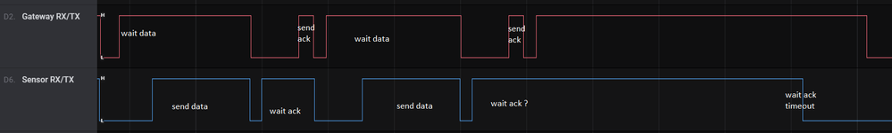

I use two X-NUCLEO-S2868A2 board with blueNRG-2 with BlueNRG-1_2 DK 3.2.1 and S2-LP_DK_1.3.2
I use following RF configuration :
#define MODULATION_SELECT MOD_2GFSK_BT1
#define DATARATE 50000
#define FREQ_DEVIATION 25000
#define BANDWIDTH 100000
#define POWER_DBM 14 SRssiInit xSRssiInit = {
.cRssiFlt = 14,
.xRssiMode = RSSI_STATIC_MODE,
.cRssiThreshdBm = RSSI_THR,
S2LPRadioRssiInit(&xSRssiInit);
S2LPRadioCsBlanking(S_ENABLE);
2 : Sometimes the app stuck in SpiRawTransaction() in S2LP_CORE_SPI.c :
while(!DMA_GetFlagStatus(DMA_CH_SPI_TX_IT_TC));
DMA_ClearFlag(DMA_CH_SPI_TX_IT_TC);
while(!DMA_GetFlagStatus(DMA_CH_SPI_RX_IT_TC));
DMA_ClearFlag(DMA_CH_SPI_RX_IT_TC);It stucks only in the DMA_CH_SPI_RX_IT_TC while()
Should I use a timeout and try to redo or change the function to polling/IT spi like in peripheral navigator example or am i missing something ?
Thanks,
Andy.

2021-03-17 6:11 AM
For 1. Replace RSSI_STATIC_MODE by RSSI_DYNAMIC_18DB_STEP_MODE seems to help but still packet loss.
Section 5.5.8.2 from https://www.st.com/resource/en/datasheet/s2-lp.pdf
"the carrier sense signal is asserted if the signal is above the threshold and a fast power increase of 6, 12 or 18 dB is detected". Is AGC could help ?
