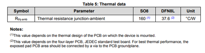

1) ST890DTR
What's this, then:

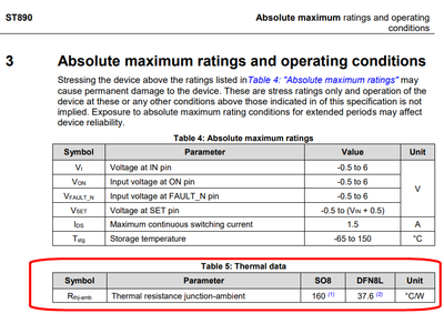

You have to read the datasheets yourself and calculate thermal resistance, depending on copper area you put there.
And from ds you see some typical value:
