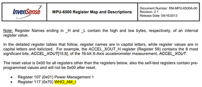

Mind the part names. There are several with similar numbers, but they are different parts. MPU-6000 and MPU-6050 documents shouldn't be used for the MPU-6500.
The MPU-6500 has a WHO_AM_I of 0x70, which is what you're reading, so all is well.
https://invensense.tdk.com/wp-content/uploads/2015/02/MPU-6500-Register-Map2.pdf
