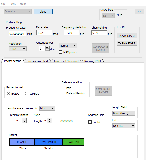

Both SPIRIT1 and S2-LP can be suitable for the task.
It can be simply configured through SPIRIT1 / S2-LP DK GUI, on top of a STM32 Nucleo board + SPIRIT1 / S2-LP expansion board, like:
I'm sure it will take less than 1 hour to setup the boards to test.
Thank you.
