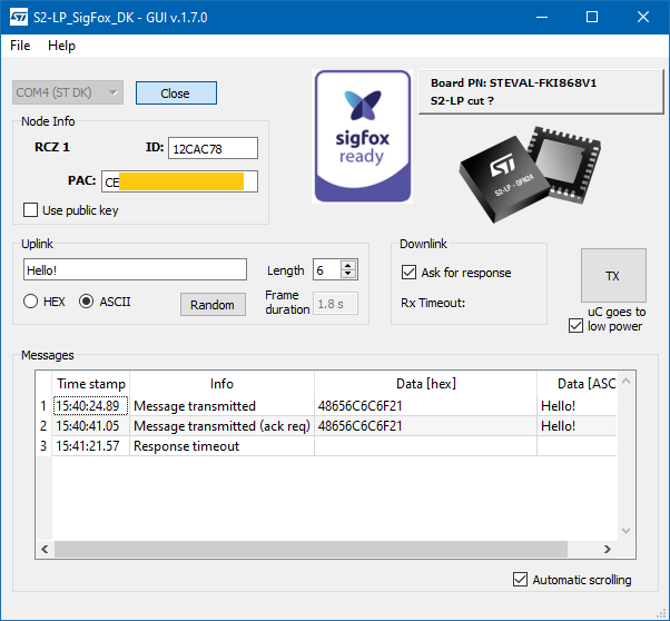

Three weeks earlier, I connected for the first time my STEVAL-FKI868V2 to the Sigfox backend and used the S2-LP_SigFox_DK-GUI (v.1.7.0) tool to send test messages to this Sigfox backend. Everything worked perfectly.
Now since 6 days I try again to send test messages with this tool, but nothing is received on the backend.

I started using the S2-LP_SigFox_DK-GUI yesterday. Was seeing the same symptoms (i.e. Response timeout) as you. I had been sending my transmissions from inside my home so I decided to send the transmissions from outside. When I was outside I started to get responses from Sigfox. However, I did not get the responses every time. My conclusion is that I have some signal level or SNR issue in my area. Not a technical response but I hope this helps you.
