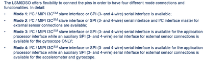

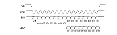

I ordered this IC for one of my products and am confused about the SPI modes. In the datasheet, it is mentioned that it will support SPI mode 0 and mode 3, but I have not found any timing diagram of SPI mode 0 in the datasheet. Can you provide me more details about this IC How can I change the SPI modes and on which mode this IC works fine, and the timing diagram of SPI mode 0?

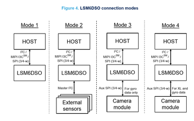

I think, its not explained in a clear way: mode0 is 4-wire , other mode is 3-wire SPI , depends on SIM bit in ctrl3_c register.
"mode" is also used for the operating mode , so this is confusing somewhat, see:
Also the interface can be in different "mode" : SPI , I2C , I3C -> depends on pin settings
So there is no "better" timing on SPI, just 3 or 4 wire mode can be selected, default is 4 wire SPI.
I would try this 4 wire SPI first.

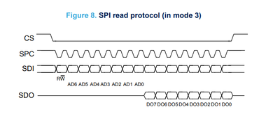

Thanks for your reply. I think these are not SPI modes. These are connection modes. I am asking about the SPI modes. In the datasheet, it is mentioned that it supports both SPI modes. Mode 0 and mode 3 as you can see in the attached screenshot.
But there is no timing diagram available for SPI Mode 0.

Yes, but this i tried to explain: SPI has 4 or 3 wire mode, thats it. Other is the operating mode ...3 or whatever;
(as i understand this ...)
If there is a "spi-mode 0" with different timing or whatever, there is nothing about in this ds.
