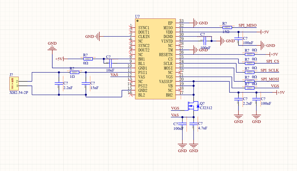

我的 L9663 SPI 无法正常工作,我想通过寄存器读取L9663的设备ID,但接收回来都是0XFFFF。我现在使用的MCU是STM32F103C8T6,以下是我的计划,希望大佬们帮我看一下有没有问题。
2024-09-12 4:24 AM
Translation:
My L9663 SPI is not working properly. I want to read the device ID of L9663 through the register, but the received data is 0XFFFF. The MCU I am using now is STM32F103C8T6. The following is my plan. I hope you can help me check if there is any problem.

@mochensama , Hi, have you solved your problem? I designed the circuit with reference to spec, if you use PSI5-P mode, you shouldn't pull up BH1 of pin8, right? Also are you using 5V for VASSUP? I feel like it's usually with a higher voltage, right?
This post has been translated from Chinese to comply with the ST Community guidelines.

Hello, have you solved the problem?
I am a first-year graduate student. I am also encountering this problem now.
*This post has been translated from Chinese to comply with the ST Community guidelines.

可能是VDD电压不对,芯片手册提到spi电压由VDD决定,通常STM32F103的spi电压为3.3V,l9663在VDD供电为5V 的情况下,SPI电平为5V,可能会导致此问题。在第六章的Table 23. Digital I/O的Vout_High可以看的明确证据
