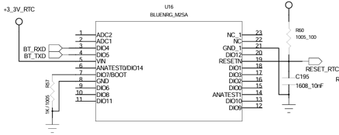

I have configured the hardware to use BlueNRG-M2SA(DIO4, DIO5) with STM32L053R8T6 via LPUART1(PB10, PB11).
The connections are as follows:
  • M2SA DIO4(UART_RXD) <-> CPU PB10(LPUART1_TX)
  • M2SA DIO5(UART_TXD) <-> CPU PB11(LPUART1_RX)
  • RESETN is pulled up to 3.3V via a hardware pull-up

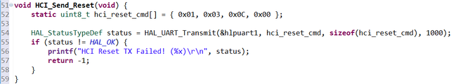

To verify the hardware setup, I set the LPUART1 baud rate to 115200 and sent the HCI_Send_Reset(HCI command) to the M2SA. However, I am not receiving any response.
I have confirmed that the LPUART1 transmit/receive functions work correctly when tested separately from the M2SA module.
Are there any specific hardware configurations required to enable UART communication with the M2SA?
