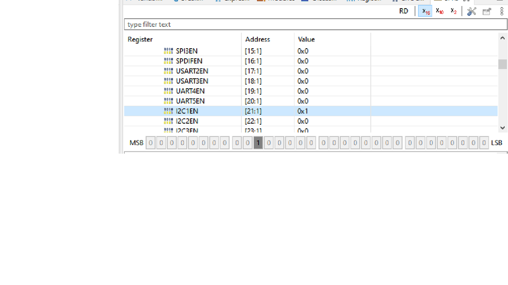

I2C1 is clock is enabled in RCC register

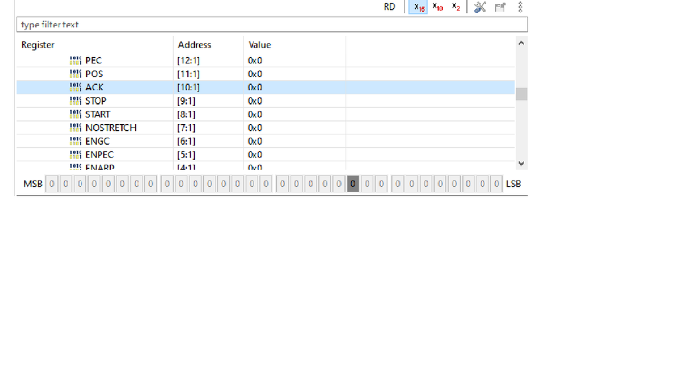

After setting the ACK in I2C1_CR1 it is not getting set

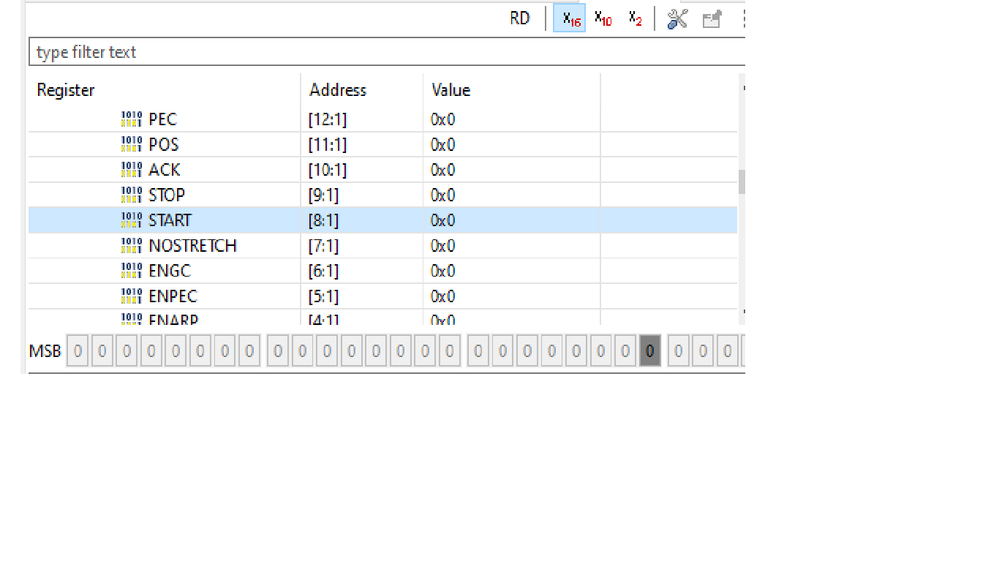

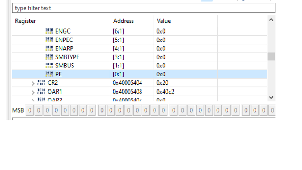

@TDK As you said I also tried to enable PE after I2C1 init but PE and START condition are not getting enabled.
START:
PE:
Am I missing anything?
