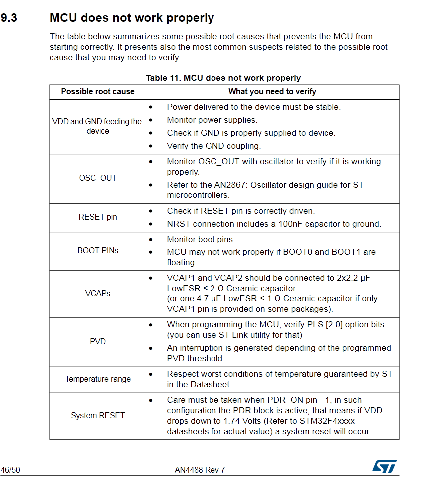

Is there actually nothing connected to the VCAP pins as it appears above?
That would be a problem...

It seems that I'm missing VCAPS and PDR_ON, I will try both!! Thank you

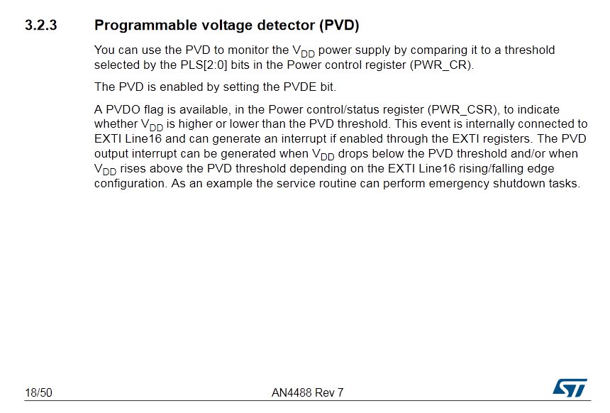

PVD I didn't understand what they mean, maybe does not exist in stm32f427?
2023-01-31 10:04 AM
If you have not enabled the PVD, I don't think that it is of concern.
