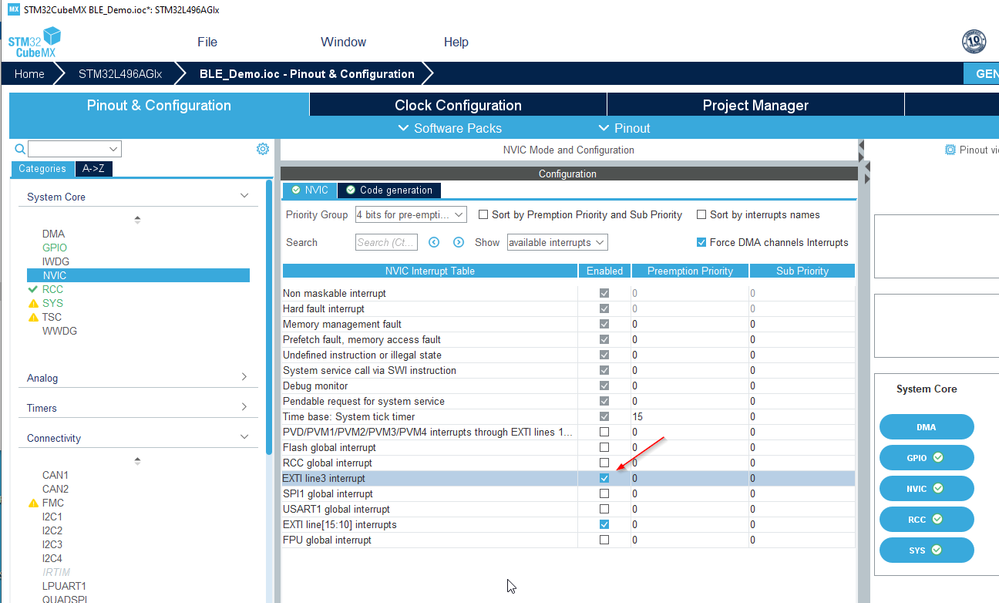

from your ioc I see you did not enable the EXTI line3 for the BlueNRG interrupt.
You should enable it as shown in the attached picture.
The EXTI line[15:10], also enabled in the picture, is used for the User Button that is configured in EXTI mode.
Please, let me know if this solve your issue.

It's working thank you so much
