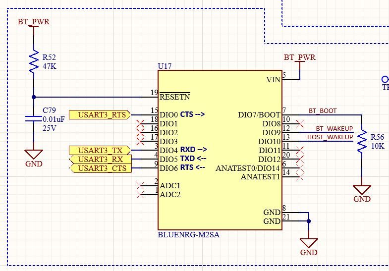

My schematic is currently wiring up a STM32L475RC processor to the BlueNRG-M2SA module as follows.
USART3_TX --> Pin 3 DIO4
USART3_RX <-- Pin 4 DIO5
USART3_RTS --> Pin 15 DIO0
USART3_CTS <-- Pin 9 DIO6
I have our RTS signal connected to DIO0 instead of DI07 because we plan to actively drive DIO7 as part of the BOOT feature. I would like to use whatever the default UART pins are so as to minimize software work.

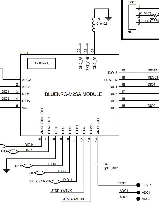

I also have a question about the GND on pin 21. On the schematic for the STEVAL-IBD008V1M evaluation board, this pin is called GND_RF. There is also an inductor L3 in series between the pin and GND. Is this needed and if so, what is the value or manufacturer part number? This is not described in the datasheet.
I have attached a snippet of our preliminary schematic. I also attached a snippet of the the STEVAL-IBD008V1M schematic which shows L3.

Could you clarify which FW you are planning to use inside BlueNRG-M2SA?
Is it a DTM UART so that you will use it as network processor?
Will it have sleep mode?
If HW flow control mandatory ? What is UART speed targeted here?

About pin 21, my recommendation would be to be as close as possible from our STEVAL-IDB008V1M eval kit. as can be seen here, pin 21 is linked to main ground through a 0Ohm resistor.
