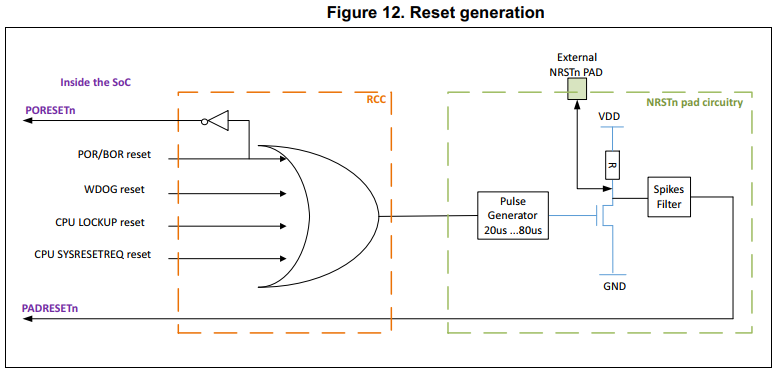

Thank you for answer, this example is to inform the reason after a reset, I was looking for a function when WDG reach 0, execute some code and then reset. I guess it's not possible on bluenrg-LP as the WDG is fully independent and directly connected to reset, this is a more secure version, unlike in bluenrg1/2 where there is WDG interrupt(so need to run code...)

There is a code example in BlueNRG-LP showing usage of independant WDG.
...\BlueNRG-LP DK1.1.0\Projects\Peripheral_Examples\Examples_HAL\IWDG\IWDG_Reset
Concept is to check Reset Reason code at startup.
Reset reason is stored in RAM_VR virtual register.
In case of reset because of watchdog,
in RAM_VR.ResetReason, RCC_FLAG_WDGRST should be high.
