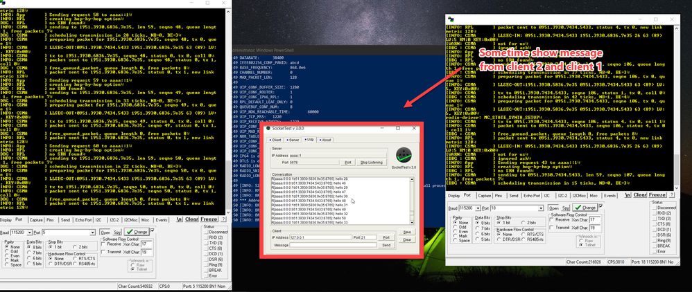

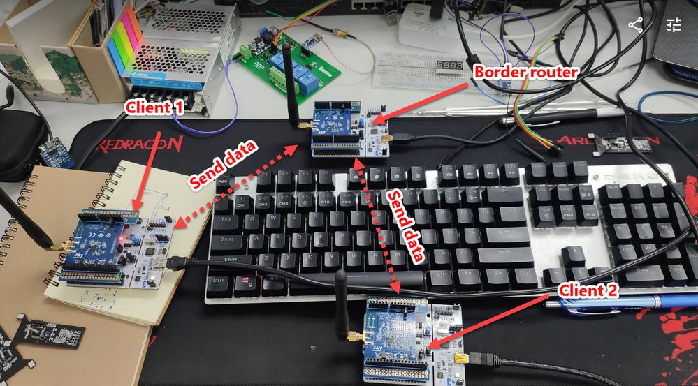

I am try this your solution. My network is not mesh tropology. show photo below

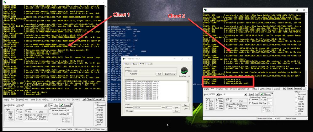

This photo. Client 2 should send the data to Client 1 then Client1 send the data from Client 2 to Border router.
This photo to show message client 1.

if you configured both the UDP Clients to send data to "aaaa::1" address it is normal that you see the UDP messages on the UDP Server running on the host, this regardless the fact that the network topology is star or mesh.
To try to setup a mesh (multi-hop) you can try to setup a linear topology with the second node in the radio range of only the first node:
BR ------- NODE1 -]------ NODE2
Where ']' is the end of BR's radio range.
