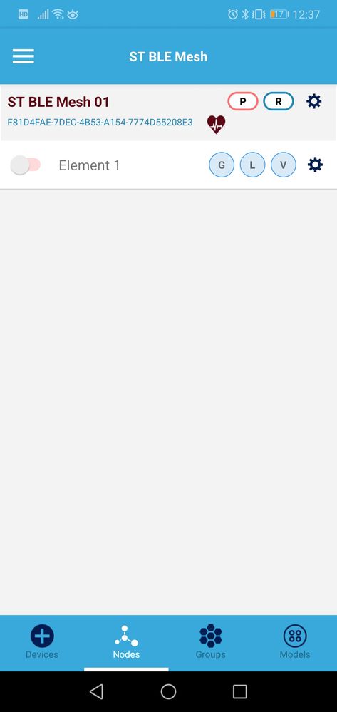

2116 Appli_Generic_PowerOnOff_Set - Appli_Generic_PowerOnOff_Set callback received for elementIndex 1Then, when I provisioned the device using ST BLE MESH app, I got the following message. Only Element1 is displayed in app as attached.
Does it mean that the element 2 is not available in ST BLE MESH app? How can I use element 2 and Light LC Server Model?

2021-01-11 8:06 PM
In BLE Mesh SDK, multiple mesh libraries exist with different configurations. The default mesh library supports one element only.
A library supporting at least two elements shall be used. Please link the appropriate library available at path Embedded\Middlewares\ST\ST_BLE_Mesh\Library\libBlueNRG_Mesh_CM0_2E_1N_1A_12M.a
