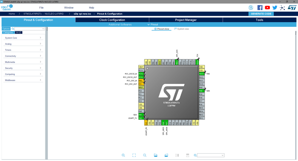

I tried to develop my own code for s2lp on NUCLEO-L476RG
my setup include:
NUCLEO-L476RG+s2lp FKI433v2 on top(RX working fine)
NUCLEO-L476RG+s2lp FKI433v2 on top(TX cant go to TX mode)
NUCLEO-L053R8+s2lp FKI433v2 on top(as a test for both RX and TX)
I was able to receive messages with the my code on the RX side the message was from the L053R to my L47RG
However when I Tried to send From TX L476RG it Wouldn't send Nor Got to TX mode

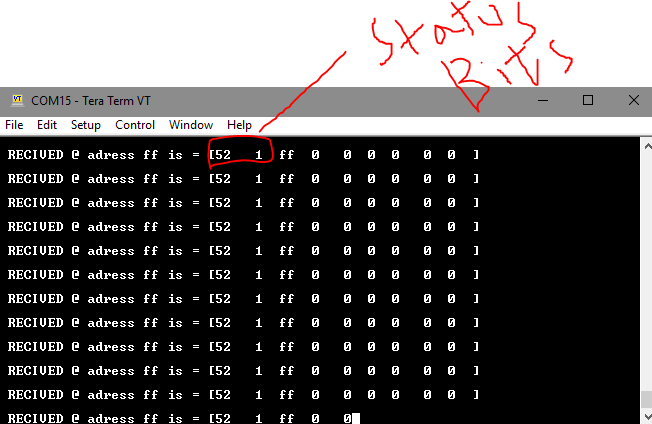

I know this because i saw the S2lp status Bit after I sent the TX Command it didn't go to TX MODE but Went to Ready only
The status Bits were(52 1)
I am using kiel V5 and did initialize with Cube MX

sprintf( buffer3, "\r\n RECIVED @ adress %x is = [%x %x %x %x %x %x %x %x %x ] \r\n",SPIBuf_WRITE[1],SPIBuf_READ[0],SPIBuf_READ[1],SPIBuf_READ[2],SPIBuf_READ[3],SPIBuf_READ[4],SPIBuf_READ[5],SPIBuf_READ[6],SPIBuf_READ[7],SPIBuf_READ[8]);
for(i=0;i<=strlen(buffer3);i++){
buffer1[i]=buffer3[i];
} i=0;
// sprintf( buffer3, "\r\n RECIVED is = [%c %c %c %c %c %c %c %c ] \r\n",UARTBuf[42],UARTBuf[43],UARTBuf[44],UARTBuf[45],UARTBuf[46],UARTBuf[47],UARTBuf[48],UARTBuf[49]);
HAL_UART_Transmit(&huart2,&buffer1[0],150,500);
// HAL_UART_Transmit(&huart2,&SPIBuf_READ[0],18,500);
FLUSH_FIFO();

2019-09-24 1:23 PM
Hi
I got it fixed the main thing was that i changed the
PCKTCTRL3 RX mode direct through FIFO
and
PCKTCTRL1 TX mode direct through FIFO
then i was able to to change it to TX mode
I was able to send and receive with s2lp but i couldn't do the RCS so i disabled it
